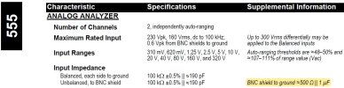

I am an experienced electronics engineer and I make a living from my work. I have published in this thread the measurements I have personally made on my SRM-006tS, which show that they are good, yet in the opening pages of this thread there are still the incorrect measurements of Amir. And there are also other incorrect statements such as "Here is the SMR-006t which is also tube based but its output is not differential:". It's not true! The SMR-006t is fully differential (and impedance balanced), as you can already see from the block diagram I attach below. And again about the measurement system, Amir says "AP's 'unbalanced' input is floating so nothing was reference to ground but to the differential pair", which is not true. In fact AP's specifications say that the shield of the unbalanced input goes to ground with an impedance of 500Ohm||1uF, and this means that he has practically grounded one of the differential outputs (considering the left channel, L- or L+). This is further demonstrated by the fact that in all the measurements made by Amir of all the Stax, the second harmonic is higher than the third which is not what we should expect from this type of amplifiers.

No. In fact your measurements are aligned with those I made on my SRM-006tS, which is the original without CCS. The measurements reported in the first pages of this thread are wrong. I explained the reasons in my posts.
