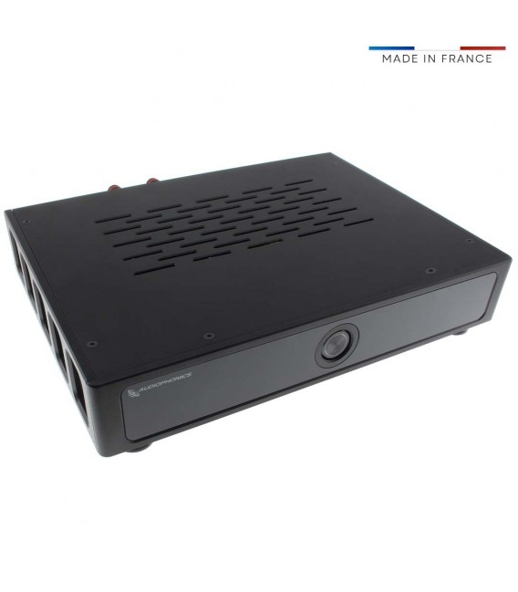

I don't think I have to worry about power. I am using this:

But that doesn't mean anything unless you know the output voltage of the source device.
What source device are you using?
