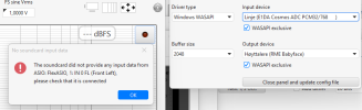

Tried also the flex asio driver with wasapi, But not friends with ADC-iso yet. Crash when start FFT. CAn turn on signal on REW
View attachment 413627.
WDM is OK
Using WASAPI exclusive with standard non ASIO windows driver. Working OK.
So thats OK for me
64bit REW has Wasapi Exclusive built-in (called Java EXCL there), so there's no reason really to use FlexASIO anymore.
