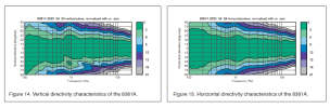

To me, the measurements provided for the Genelec 8381A makes it look somewhat inferior to the Dutch & Dutch 8C, at least in horizontal dispersion.
It does not look as well controlled in the Genelec 8381A, there's a widening at 1kHz and it's overall horizontal directivity is not as constant.
Obviously the Genelec 8381A is in a completely different league when it comes to output and it's greater point source attribute means one can site more above or below it.

I'm not sure I can see the 8C's clear superiority compared to any Genelec's horizontal dispersion; and Genelec does not only do coaxial designs.
The 8C reaches down deeper in this comparison, but at the big loss of headroom as has been mentioned before.
I think the 8361 looks a bit ragged in comparison and does not control directivity as low. It also looks a bit lean in the bass.

I could be wrong, but I think the Genelec 8380A is narrower than the 8318A in dispersion. The 8318A looks superior to me.
Genelec know what they're doing, I think both of these speakers are deliberately designed to be narrow in dispersion to reduce room interaction in larger studio rooms. I don't think they really give any consideration of using these speakers in a typical domestic environment (not that they can't sound good there too).
