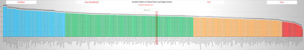

This places the G7 above average of every amplifier tested to date if we use RCA input:

This places the G7 smack in the middle of every amplifier tested to date:
