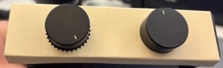

Using a custom-cut front panel template in order to hand-adjust the Douk A5 HPF at uniform intervals, I output a sine sweep (5 Hz to 5 kHz) repeatedly through the Topping DAC, generated WAV files from the input of the Behringer UCA222 interface, then generated the attached graphs from the FFT curves of all the WAV files.
Thank you for the effort.
If I counted the template correctly there are 32 "spokes" total. Between "on/30" and "200hz" I count 25 positions corresponding to the curves in the graph.
I have sketched the template star on paper and assigned a number to each spoke corresponding to the graph to help me visualize where to place the pointer between 7:00 and 5:00 on the HPF.
The curves are kinda crowded below 80hz, but it's still serviceable for my application.
