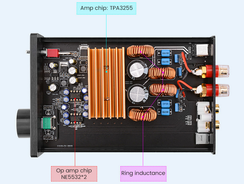

There's one thing I find suspicious, though. Why does SINAD increase slightly on both channels when @amirm replaces the 5532 on one channel with the discrete op-amp?
Are there additional buffer capacitors on the discrete op-amp's circuit boards?
This has nothing to do with that but rather the fact that one channel has original opamp and the other channel has the expensive one.
No 2 channels measure exactly the same and even when he would have measured the same channel such 'differences' are to be expected and in the realm of tolerances.
Basically you are looking at the SINAD of the power stage (which is much higher in distortion than the opamps could ever add).
There might be some other limiting factor in this particular amplifier as NE5532 can do better than THD+N 0.003.
There is ... the output stage !

Roughly two years ago, I went random opamp rolling, as I had time to waste. The only difference was when the socket started to wear due to my countless swap-in/out. I got significant distorsion in one case (which I could not hear).

I won't name the manufacturer, but for instance a brand that offers Purifi 1ET6525SA amps offers a myriad of OP Amp options. The Sonic Imagery 990 adds $300 to the price of a monoblock build. The Weiss adds $500.
It's a rip off/cash grab.
Even well-known manufacturers who base their amplifiers on TPA32XX chips do so. I'm pasting a post I made in another thread, from page 7, #139:
Holy shit, this is what Aiyima themselves have to say about what it sounds like with different op amps in their A04 & A07!:oops:

Without knowing anything about the circuit design or taking any measurements whatsoever... why do people think they can do better than the device engineers by randomly swapping opamps? That is more the question...
