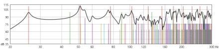

7m x 4m. Reasonably even from 23Hz on up... with some peaks that can be knocked back down using EQ..
Would you advice placing the sub in the middle?
From my own personal experience, yes I do advise placing in the middle. My subwoofer is now in the middle and the soundstage & male vocal phantom center is much better, bass tonal variation is lesser (less super peaks or super dips).
Previously my subwoofer was at the far right side of the front wall, where on some tracks the bass sounded odd/wierd, and some male vocals sounded a bit diffused when supposed to be centered.
