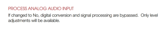

Edit:
According to the User Manual, digitization can be bypassed:
Therefore:
Source format: DigitalSource format: Analog
DSP desireduse direct digital inputturn on Process analog input.
Use analog input, or an external ADC (e.g. PocketADC) if you find the Anthem's internal ADC adds noise
DSP unwanteduse direct digital input, or an external DAC with 'Process: No' if you find that the internal DAC adds noise.Use analog input with Process analog input turned off.

Edit:
Therefore:
Nice find, thanks! I’m assuming accessing any of the sound modes (AnthemLogic, DTS Neural, etc…) would then not be used (to keep the AVR’s DAC out of the equation). So, you are going to only listen to 2-channel, which I’m sure external DAC proponents would exclusively use anyways.
