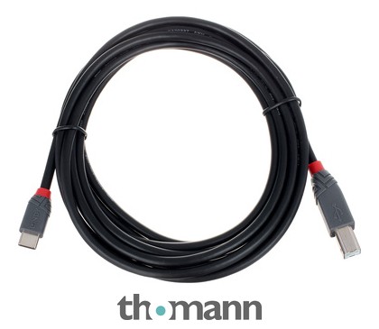

Thanks so much for your insights Roland! So I'm planning to connect via the USB-B input on the DAC. I have to select a cable to run from my laptop to the DAC.
This is one from Chord I'm considering:
This is a much less expensive one from Lindy that also looks good:
Here's another one that is even more expensive than the Chord:
Of course, Wire World Cable offers less expensive cables.
Just to make sure I understand your recommendation - you're saying go from USB-A on the laptop to USB-B on the DAC using a USB 2.0 cable. If that's the case, I'll restrict my searches to this type of cable.
Thanks for all your help!!!!

For HiFi DACs, my recommendation is generally a pure USB 2.0 cable, and if possible with USB A and B connectors, but that only applies to the robustness and durability of the connectors.
In my experience, special or expensive USB audio cables aren't worth it at all. If you're looking for a bling bling cable, just get a Lindy Cromo Line, or build one yourself, then at least you know it's not junk.
A few years ago, we conducted a blinded listening/comparison test with cables up to the mid-four-figure range. We then cross-checked it with a USB analyzer, and the results were absolutely conclusive. One of the best cables was an HP USB cable that HP used to include with its business devices.
Anyone who wants to spend more than €10 or €20 on a USB cable should think about it.

Ordered the Lindy Cromo line as you suggested. Thanks!
