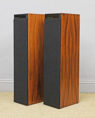

Actives still make sense in most of my systems. Have multiple pairs of legacy Meridian DSP speakers that are still performing well after decades of use. The simplicity of having everything contained in one enclosure DAC/AMP/PRE makes for a very simplistic means of playing music. Feed the speakers a digital coax stream and you are good to go
Always in the shadow of the digital models, Meridian did a floor-standing analogue active (M60)
...And I remember a very pleasant sound from them. Never bells and whistles, but they just got on with it. My employer was more into active Linn and Naim at a much higher price and back then, Meridian were always tinkering with some of their models which kind-of put us off. These M60s weren't 'in the headlamps' so to speak, so I suspect a good buy, especially if partnered with their 502 preamp, which always 'sounded' so good I remember.
