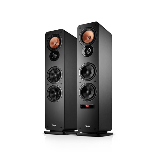

A few suggestions for active speakers
Teufel for example is very cheap
