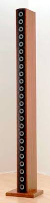

One more example. Custom-made (at the appropriate height) line arrays are suitable for DIY:
Roger Russell (RIP) was making line-array speakers like these before he passed, and after retiring from McIntosh (where he had been in charge of their speaker department during the Gordon Gow period). He made a strong case for the concept, and he is someone who didn’t sell woo or magic. They were expensive! If I wanted that type of speaker, DIY would be the only practical way to get them. But they wouldn’t be anywhere near the OP’s price point by the time one buys the 50 or so needed drivers. And, they need special equalization and a couple of subs.
Rick “actually looked into making a pair of those” Denney
I could definitely make Multi Entry Horns like in my pic for under 1500€ budget.
I'd guess with TC9 for example, which is a good driver, 50 pieces with a quantity discount, a total of around $1000?
Then a lot of milling of the 50 holes needed, but if you have the time and equipment then of course why not. Plus then having a fairly large listening room, with a fairly long listening distance, to place them in.
