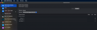

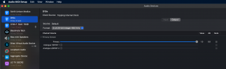

Hello all, It seems a lot of people in this thread have similar setups to mine and I was seeking some help. I've been trying to get my 2.2 system with DLBC up and running for about 4 days now with no luck. I'm using a Mac mini with two separate dac's. The Mac mini is the M2 and I am new to Mac.

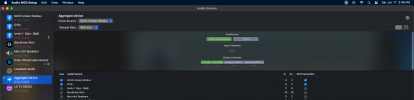

In the MIDI settings, I created an aggregate device with the two dac's and set the speaker config to stereo. Dirac virtual audio device is selected as the output device and its speaker config is set to stereo.
In the Dirac processor, selected custom channel config and stereo then added two subwoofers. Under audio settings of the processor aggregate device is selected and all four outputs are selected.
My problem is that during media playback from the Mac, only output from one dac works. If I hit test under the Dirac processor audio settings I get output from both dac's 2 subs and two speakers. If I start the Dirac calibration I see two speakers and two subwoofers. Calibration works as intended and output comes from each individual speaker. After I safe the settings there is zero output from my subwoofers. I know they are not even receiving the signal because at one point I had a minidsp as one of the dac's and watched the software plug-in. I've switched RCA's and then the subs work and not the speakers so I know all components are in working order. I just have a routing issue somehow.
Something else odd..If I select the aggregate device as the playback source vs the Dirac virtual audio device and play any audio I have a lot of loud static that plays along with the source.
Could this routing issue be seen in image 1? Stereo is selected as the config so only two speakers show. My two devices are listed at the top and two output routing options at the bottom. How should this be laid out?
Any help is much appreciated.

In your first photo (1.png), try changing the configuration to quadraphonic.
Same result. With Dirac virtual device as playback, I only output from my speakers. If I select the aggregate device as playback just playback from just speakers and lots of static. If I select this as stereo and choose the two dac's at the top and select a speaker from each of them I get playback from one speaker and one subwoofer. This tells me the Mac is seeing the two separate devices and can play from each of them at once.
Well then it sounds like the aggregate device itself is not working. Try checking drift correction on both. If that doesn’t work try swapping the drift correction settings. It sounds as if the DACs aren’t properly syncing.
I just tried that with no change in the outcome. the one change that occurred is if i selected the topping dac 1st in the aggregate device I get sounds from subs only vs speakers only. Is there a reason why the topping shows the primary volume all the way up and the schiit dac does not? There is no volume control on either dac just a heads up.

Hmm, I saw your image #3 that says "topping internal clock" and said WTF? Then I looked up Topping D10s and see that it's a DDC as well as a DAC. I doubt it but, if the D10s shows up as a 4 or more channel USB input, your (elegant) solution would be to chain the Schiit to the Topping using SPDIF out of the D10s DDC feature and skip the aggregate device. Since that's probably not possible, I'd go back to first principles by making sure you can send audio to each DAC separately (without static) and then recreating the aggregate device with the Schiit set for drift correction.
This is above my pay grade but, I believe as a DDC, it has to be the clock master (which doesn't apply to USB) so you may be SOL using the Topping in an aggregate. In otherwords, the D10s might not be a DAC that can be used in an aggregate device. Any way you can beg/borrow another DAC to try instead of the Topping? Otherwise, sorry, I'm out of ideas and maybe someone else can chime in.
The topping won't let me choose the input tab. I have other dacs here and tried the last few days. One was a mini dsp tho which can be a ddc. It just occurred to me that I have switched multiple dacs but the schiit has always been in the chain. Let me swap that out real quick to see if that changes anything.
I did as you suggested and selected each individual device, making it the source and confirming playback. I had no issues here but one thing did catch my eye. The topping still allowed me to adjust the volume on my keyboard and the Schiit did not. Typically on a Mac you only lose volume control when selecting an aggregate device.
Swapped the Schiit and same results.
