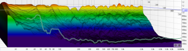

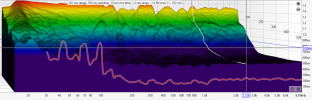

ART came sooner than I thought and, as I expected, fixed this issue. Here is the comparison between DLBC with 3 subs (green) and ART with 4 subs (red).
Subjectively, I feel the system sounds much better, the boomy bass is gone and e.g. I can listen to some pop music without reducing bass with and equalizer. I am discovering some details I have not noticed before. I am really happy with the results. But the measurements seem to paint mixed picture. The second image shows RT60 for DLBC, and the third for ART. It does not look better, does it?
On the other hand, spectrogram of ART looks smoother.

It looks like your infrasonics are not switched on in ART. As your bass quickly drops off below 20hz. For each group you can check a very small box on the far left of the support herz range of the sub. This will give you back your infransonic bass. Dont check the boxes for the other speakers in the group btw, this will send infra to them which most FCL/Surround can't handle.
That spectogran looks exactly like it should be I think
Am not an expert in rt60 but you would think that should than also look better....
Happily we live in a subjective world : )
Thank you. I was thinking about enabling the infrasonics, but only 2 of my 4 subs are able to do it, and when I split them to two groups, the new group does not allow me to specify the target curve or any other parameters. I assume it is a bug, and I need to contact Dirac support.
