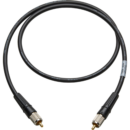

For super nice cables, a 75 ohm coax with Canare connectors is a good choice.
