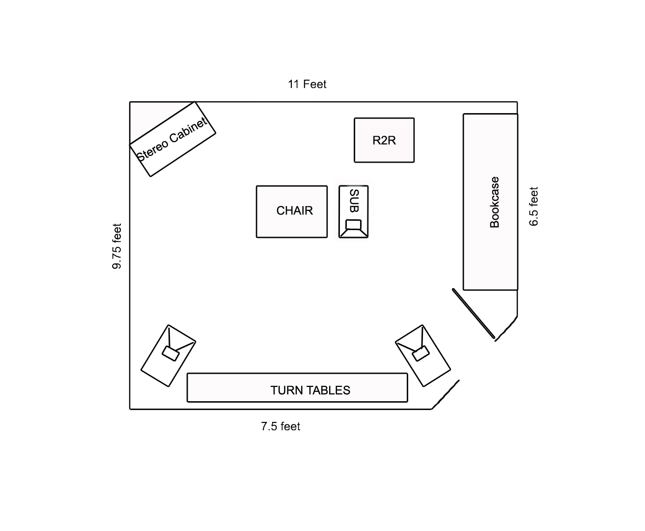

I've got it all in a small and odd shaped room:
It was originally my home office, but became the full time "audio room" once I retired. Odd shaped, asymmetrical and small. Far from an ideal audio room, but we all work with what we've got...right?
I figured if I was going to get as much out of it as I could, I needed to get a little more "scientific" about it than random chance placements and my old, damaged hearing.

I ended up handling most of the low freq nulls and dips by experimenting with listening position and sub positioning. I ended up with a near-field sub, right under my lh armrest. It was literally sensitive down to a inch in difference fore and aft in "helping" cancel out some nulls. Lateral moves were less sensitive, but it was also fairly picky about that too, down to a 2-3" inch move in either direction being worse. Small rooms are just fussy: go figure.
The seating/listening position ended up less than ideal for the space by "conventional wisdom", but it was a necessary compromise between nulls and being able to actually use the chair and still be able to move about the room without wanting to throw the chair through the window. I still have a null at 50-51Hz, but it's narrow, a smooth transition into it and strong recovery at about 52-55 Hz. I'm calling that "manageable". At least for now with what I have at hand.
SBIR is a fairly deep/wide null around 130Hz, but positioning helped make the entry smooth and shallow and the recovery the same. I can pretty much make it go away with moving the towers to 3" from the wall behind them, but it introduces even worse compromises elsewhere and imaging just goes completely to pot. So I'm accepting the 130Hz null where it is for now. I'm not even sure i can "hear" it but REW says it's there so I'll get around to dealing with it in other ways later down the road.

The good news is the sound stage is absolutely fantastic on the listening test. It's a little on the narrow side because the "triangle" is a little smaller than conventional wisdom says it should be on the base measurement. But that's fine as I listen to a lot of detailed stuff anyways and the width is just fine for my preferences, or at least I'm perfectly happy with what I'm hearing. I followed the numbers, not the generally accepted "rules of thumb". The left/right balance is really good, even with the room asymmetry. Listening impression is also a perception of clarity, detail and delicate separation of the instruments. The "phantom speaker" is dead on the money as is Neil Peart's drum rolls transiting across the sound stage, the left/right crashes and his snare hits and kicks dead center stage. Just wonderful.
I still have a little problem with the rh tower pointing into a corner, but careful positioning minimized the bad stuff happening in there and I'm hoping a trap will help tame it a bit more on further REW measurements. As it stands, I honestly can't hear any issues coming from the rh corner right now, but it's probably that "the best you know" thing again. Maybe I'll hear a change when the traps go in, maybe not. I'm under no misconceptions that the SBIR it will go away with trapping because it's an "unchangeable" geometry issue. I'll be happy if it just tames it a bit on the measurements.
I think I'm pretty much at the limit of what I can do with positioning as I'm pretty sure I've just hit the limits of the physics of the room.
Next steps are probably adding a second sub to see if I can't excite that 51Hz null a bit more with an additional/differing position and some absorption schemes to try and smooth out the 130Hz issue.
First will be a couple "traps" behind the speakers (2" space, 6" Rockwool safe n sound and another 4" of space). I'm limited to 47" of height due to switches and other wall fixings. That's still a good 4-5" taller than the towers. I'll do a couple sweeps to see what it does and then on to ceiling clouds.
