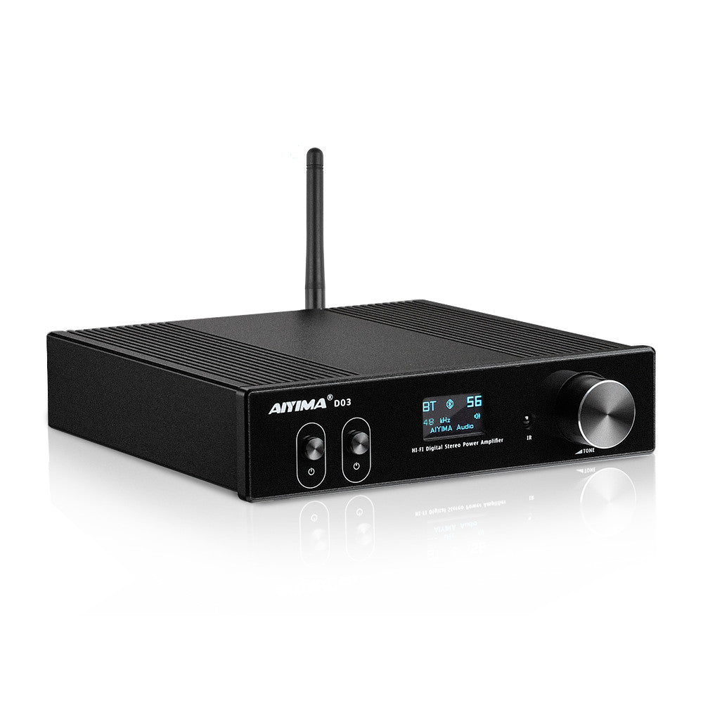

Maybe this one ...

That is one of the list I have, although the shop suggested the SMSL AD18 V3.1.
I'm trying to review a few from this site to have a better idea and make a 'short list'
