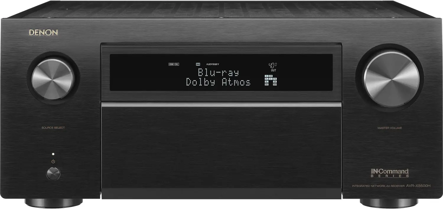

So, I’m in a similar position. I can buy the 8500HA or the 6800H for the same price.
-I don’t plan on getting more than 2 subs.
-I only plan on running a 7.2.6 Auro 3D setup.
-I do not plan on getting DIRAC.
-I have 4ohm bed layer speakers (Elac UniFi) and am getting 6ohm height speaker (Aperion A5). Since these are power hungry speakers, I’m probably going get an external amp.
With this in mind, if both the 8500ha and the 6800h are the same price, is there any benefit to the 6800h?
Do they use the same DAC? Any software differences? I know the 6800h can be later turned into an external amp, but if I’m getting one anyway, does that matter?
You can consider the 6800 a newer processor. Whether you use the newer features like Dirac or not, it will be more valuable for resale should you choose to move on compared to the older 8500.
Dirac, X32 and 4 independent sub outputs did it for me. Could not be happier with the 6800,it's now in preamp mode running 11 300 watt monoblocks.

Good point Laika2. However, my bed level speakers are Elac Unifi
-4ohm nominal impedance,
-85 efficiency,
-minimum 40watts,
-maximum 140watts,
-82dB at 1 watt /1 meter
My height speakers are Aperion A5
-6ohm nominal impedance speakers,
-87 efficiency,
-RMS 20-80 watts,
-peek 160watts,
-about 83db at 1 watt/1 meter
My room is 22x20x7’tall, so not small. My listening position is at 9’ away. I usually listen to dialogue at 60db listening position with peak at 90-95db (explosions). Based on all that, my math tells me I want 100-200watts per channel. The 8500 is 150watts and the 6800 is 140 watts. However, I HIGHLY doubt it would be anything near that with all Chanel’s driven). Therefore, that’s why I would consider the two previously mentioned external amps.
There is also something to be said about offloading a good chunk of speakers from the AVR to preserve its life.
However, that brings me back to my original question: with my previous conditions, as the main AVR, acting as the central processor, which is better? The 8500HA or the 6800H?

Planned 10 year ownership is all the more reason to go with the newer device. The 8500 may only be 3 years older than the 6800 but that was also the difference b/w "no Dirac" to Dirac being nearly ubiquitous across mass market AVRs! If I were in your position, I would certainly be interested in Dirac ART when it becomes available late this year/early next.
Also a measly 10W/channel difference is not going to be audible unless you can hear a mosquito sneeze!

Based on info you provided, it looks like the 6800 is the clear choice, though I would definitely use an external fan for longevity reason.
Also, a 2 channel buckeye amp, even the 252 will do, unfortunately he wouldn't build a 3 channel one so you will end up with a spare channel that you can use it for whichever channel you wish:
The Outlaw 5000, 7000 would be good choices too since you are not chasing the audiophile dragon.:)
Thanks all. Yea I think I’m sold on the 6800H. I was before, then I was having cold feet, now I’m back to it again.
Watching this Masimo video comparing the 6700h to the 6800h really showed me how much the chipsets have improved. That was really my main concern.
I highly doubt that the 8500HA (based on its release date) would have anywhere near the same processing ability as the 6800; Moore’s law and all that.
