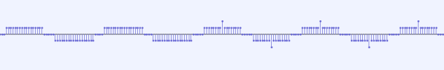

I tried to replicate the "3DC" measurement.
Please note that I do not have proper equipment to measure the signal accurately. I own an RME babyface PRO FS card. It a really nice card, but the sampled signal is not clean. It adds a fair amount of shaping noise that I had to filter out in order to get something visually pleasing. I used Audacity to do so which is not a good tool for this task.
All test signals are not dithered.
All of them were recorded on a CDRW.
I captured the analog out at 192/24.
Indeed, the dcd-900ne turns the 1KHz 3DC signal into a sine wave.
Then I investigated further. I created a 3DC frequency sweep from 14.7 Hz to 14700 Hz. I choosed 14700 because it is 44100/3. And yes, it still tries to improve the resolution of that signal by smoothing 1-bit transitions out.
In that point the frequency is about 126 Hz. The ramp is 70 samples wide (@ 192 KHz), so it is 365 uS long. Obviously the smoothing depends on the signal, otherwise such a slow rise time would destroy any high frequency component.
As the frequency rises and the period shrinks down the wave turns into a nice sine up to 14700 Hz. I can't see where the smoothing algorithm stops being applied.
I also prepared another test signal. It is a 1 KHz sine with varying amplitude from 0 to 4.
The interesting part is where the amplitude reaches the next integer value, so 1 sample wide spikes appear in the signal:
Denon's algorithm does not smooth them out. It begins doing so as the spikes grow wider. There isn't a clear threshold. It happens very smoothly.

Denon DCD-900NE - Measurements (Optical Out - From CD)
I've seen several of you reviewing CD players using their digital outputs, in case the results could be improved from an external DAC.
So let's go with the 999.91Hz @0dBFS:
No issue here, as well as with the 3DC view (997Hz @-90.31dBFBS):
You can clearly see the three DC levels -1, 0, +1 repeating. Indeed, at such a low digital level, there's only one bit to represent the signal, and so it's either negative, positive or 0. So the system cannot reproduce a sine wave, because there's just one bit on and off for a period of time. It therefore creates a square wave, which we see "suffering" from the Gibbs Phenomenon due to the band limited (22.05kHz max) representation of the Audio CD.
You can appreciate the difference when the above is processed by the ALPHA filtering of the Denon.
But I think that from now on, I will just use the intersample overs test at 5512.50Hz, with a phase shift of 67.5°, like I did for the TASCAM CD-200 review. This signal generates an overshoot of +0.69dB and so if the signal would be modified before being sent, it would show either a reduction of amplitude or we'd see some sort of saturation/increase noise/distorsion. So here we go, the below is a comparison between the WAV File directly processed by the PC, and when played by the Denon via the optical out:
The traces are identical. The Denon DCD-900NE is a "perfect" transport.
