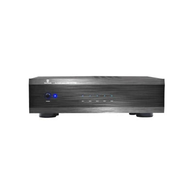

So the last two ASR reviews are for a $6500 AVR with a SINAD of 98 and an $89 DAC with a SINAD of 118. And the AVR outperforms the vast majority of AVRs.
Something is wrong here.
I understand that there are constraints and compromises in AVR architecture that make equaling the performance of a dirt-cheap standalone DAC difficult.
That suggests that a fundamental re-think of that architecture is in order. I'm not an engineer, and I don't know what the better way would be. But I have to believe that such a way exists.
I'm thinking along the same lines. I think the key element is to separate D to A conversion from audio and video DSP, and from the power amps.
One option is to get a JBL SDP-55 with Dante output and connect it to a Dante-enabled multi-channel audio interface like the RME M-1620 Pro D or Antelope Galaxy 32.
They are recording-studio quality, and have relatively high level analogue outputs that can drive some interesting Hypex and Purifi power amps without buffers.
There are lots of other interesting options.
Tonewinner 61dB Denon 95dB . That's not close.
Normal working status are Tonewinner's words, and presumably means within normal working envelope and not overloaded in any way.
The 30dB figure you quoted was only reached when the amplifier was pushed beyond the clipping point, which will be the same for any amplifier.
I really don't understand what exactly you're getting at.
There's also measured SINAD of about 68dB at 50mW aswell as at 250W (Denon). I do not dispute that at a certain power Denon's max SINAD becomes 95 dB, and at what power Tonewinner's SINAD is 61 dB, we simply do not know.
There's also this:
  • > 118 dB; ref FTC rated power; unbalanced input (A-weighted).
  • > 98 dB; ref 1 watt; unbalanced input (A-weighted). Class AB: 96dB
That's SNR at full power and at 1W. Varies with power, so does SINAD...
Not sure where you got that 61 dB from. Regardless, we shouldn't compare THD+N at just one frequency point, but if only one point is available, may be stick with 1 kHz only because that seems to be the norm for many bench tests so it would be easier to compare.
I do not see how one can do 15.4 cheaper. Denon has the only 15.4 AVR listed on Crutchfield.
Crutchfield lists 2 AVPs with 15.4: Anthem AVM90 for $7500 and Marantz AV10 for $7000.
How is it possible to get 15.4 with amplification for less than the price of this Denon? With necessary codecs included or available (Dolby, Dirac, etc.)?
People who have harped on the cost have been asked repeatedly to list components that achieve a 15.4 processor/power combination at a lower price, with necessary codecs.
Impossible, right? :cool:
Tonewinner specified parameters:
THD: ≤0.09% (1kHz, normal working status)
SINAD = 20 log 0.0009 = 61dB.
I completely agree about not using a single frequency, and certainly not the best case, which only makes everything seem perfectly transparent, which is rarely the case.
I think we should be looking for best case figures across the whole of the audio power / frequency / load envelope, because that's actually what we hear.
