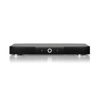

That's excellent, as I do trust Erin's reviews. For small class D amp with trigger, I would use one of the following:
Here's the one (see why I love the saving in real estate:), and the super light weight) I used with the 1800 for a few months, there was no need but I used in anyway, sold the 1800 after a few months, only because I want to do truly 2.2.
