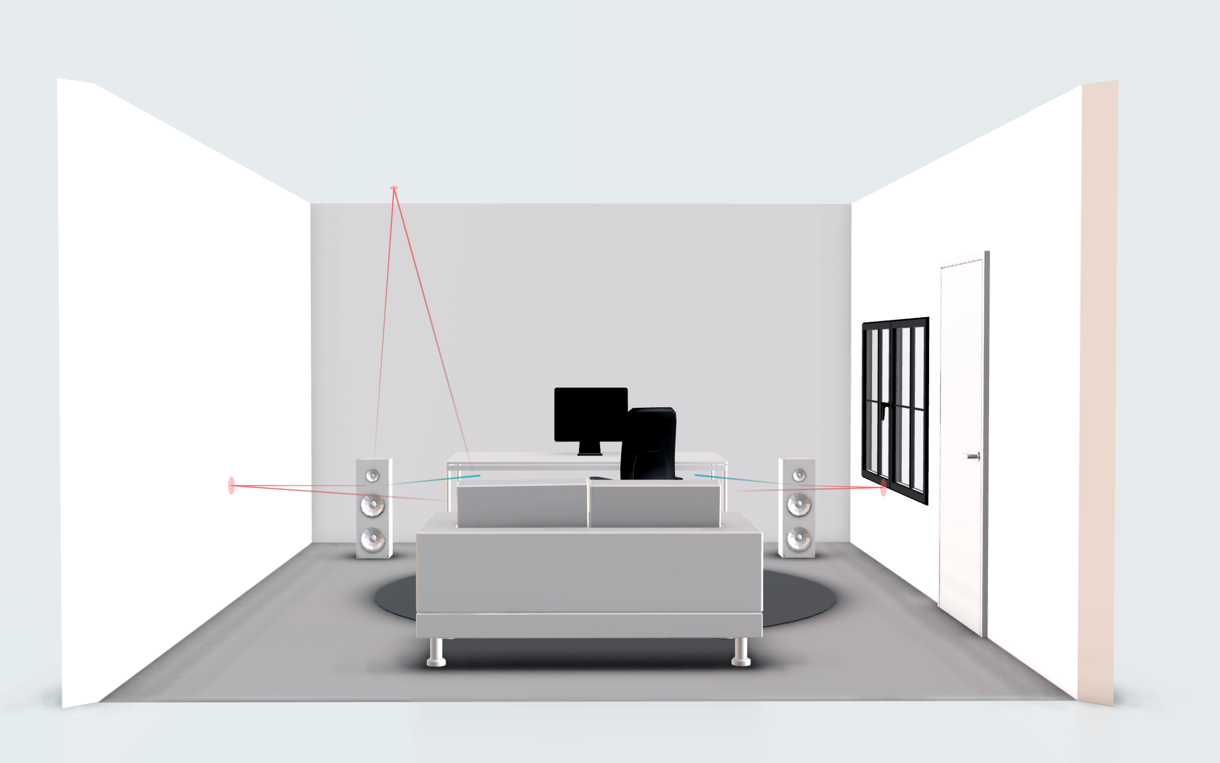

I am building something similar as your placement B(dimension in metric), it will be treated and using active DSP speakers.
Designer's rendering of the room(ignore the main speaker shown), going with Vicoustic on the room treatments
