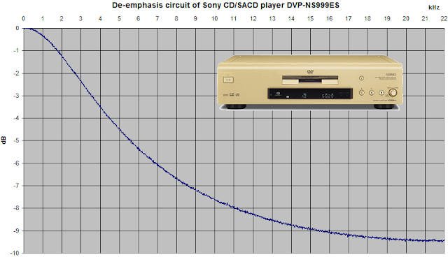

If a CD is intended to have pre-emphasis, the Red Book standard specifies this be indicated in both the CD's table of contents (TOC) and the subcode (SUBQ). SUBQ apparently requires a more intensive analysis of the TOC, and this can also reveal information about copy protection, which certain legal jurisdictions disallow - thus many/most CD ripping applications deliberately exclude reading of the SUBQ. Normally this would not be a problem ... but unfortunately there are quite a number of commercial CD's from the 1980's which were authored with pre-emphasis without this being indicated in the TOC - so most CD rippers will be unaware of this pre-emphasis.

I own a Sony CDP-101 that does De-Emphasis analogically, there was no other way back then and when an "emphasised" CD is inserted,
one can hear a relay click, that alters the resistance of the capacitor + (feedback) resistor in parallel to the opamp.
So, it has Pre-Emphasis. But on the Mac, my favourite application for ripping, XLD (I have the latest version) does not recognise this.
