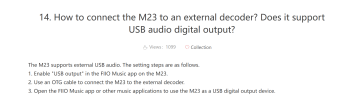

When using a USB cable with the PX8, it becomes an external DAC.
All three FiiO DAPs can be plugged into external DACs:
Screenshot 2025-09-07 163724.png Screenshot 2025-09-07 163355.png Screenshot 2025-09-07 163245.png
Therefore, FiiO DAP->USB->PX8 will work just fine.
It's an awful solution regarding price-to-performance, but it'll work.
