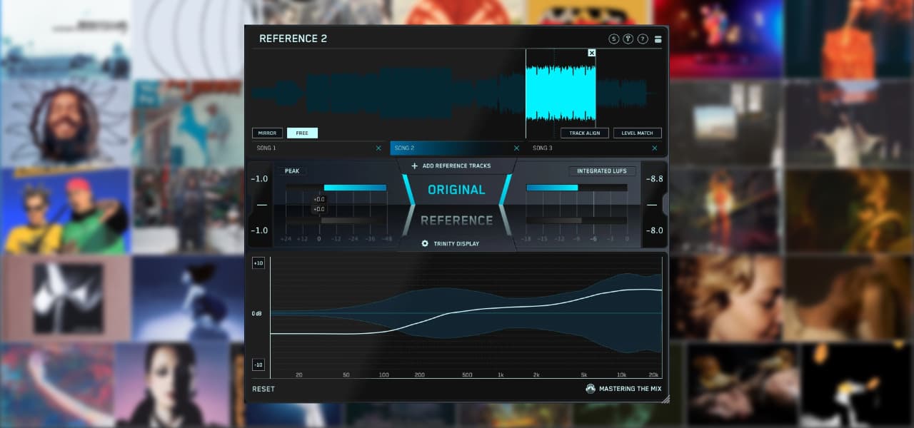

You understood me correctly - I hear sss sounds of female voices and some instruments. But I began to doubt the quality of the mixing of the tracks I was testing the headphones with and started looking for lists of reference tracks for sound engineers, and it turned out that they exist! :)
Here it is:
Almost all of these tracks NOIRE X played perfectly without equalizer and I'm shocked at how high quality and detailed they are for their price. So I will write another detailed review soon.
Here it is:
