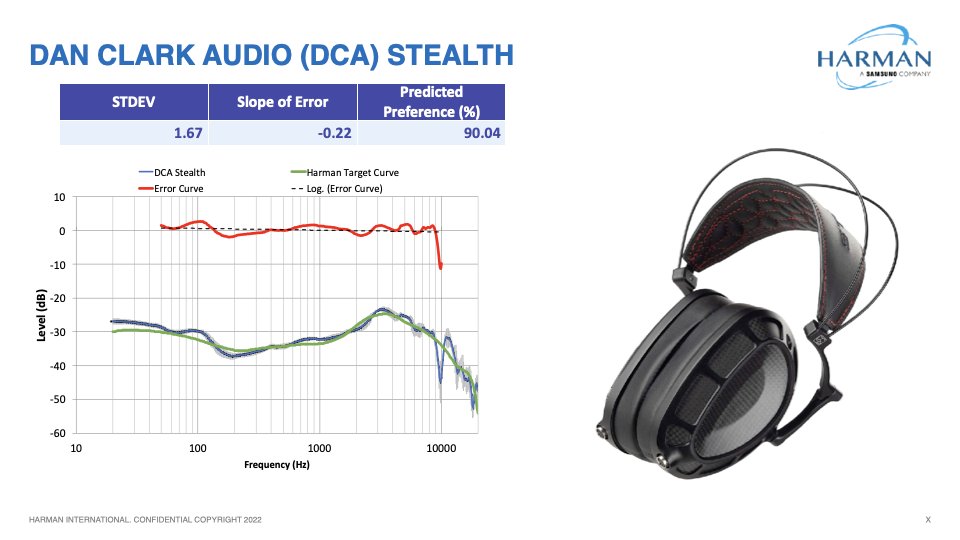

Notice even this is peaking ~2 dB above target around 3 and 5 kHz. Now let's look at all the available data (as opposed to cherry-picking sources) comparing the Stealth and Expanse. Firstly Head-Fi's measurements on their B&K 5128, which is likely to be most accurate for comparing headphone treble response, shows the Expanse has more energy than the Stealth over a broadband range between around 2.5 and 5 kHz, peaking ~2 dB above the latter's response:
Now Resolve's measurements, which again show a similar difference between 2.5 and 5 kHz:
index.php
And finally ASR which, surprise surprise, shows a similar difference yet again:
index.php
So, the gold standard measurements for Harman compliance show the Stealth peaks above target around 3-5 kHz. And all three available measurements comparing the Stealth to the Expanse within the same rig show the latter peaks above the former in this region. Therefore, the Expanse likely peaks above the Harman target over a fairly broadband range around the frequencies our ears are most sensitive by potentially up to ~3-4 dB. This is not insignificant, and should be audible to anyone who doesn't have marked age- or noise-related hearing loss (or both).

Notice even this is peaking ~2 dB above target around 3 and 5 kHz. Now let's look at all the available data (as opposed to cherry-picking one source) comparing the Stealth and Expanse. Firstly Head-Fi's measurements on their B&K 5128, which is likely to be most accurate for comparing headphone treble response, shows the Expanse has more energy than the Stealth over a broadband range between around 2.5 and 5 kHz, peaking ~2 dB above the latter's response:
Sorry, I'm with @solderdude on this one. The only measurement rig I trust to determine a headphone's FR deviation from the Harman target is a Harman measurement rig. I agree with you that this is the gold standard.
However, if you look again at the Harman measurement of the Stealth, you'll see that the measurement was not normalized to 1kHz. If you did normalize to 1khz, you would see that these so-called "peaks" centered around 3Khz and 6kHz, actually dropped down to follow right along the Harman curve.
Of course the Expanse and Stealth measure differently. They are not the same headphone. Open vs closed.
Of course they will show a similar deviation from the target on very similar test fixtures.
Of course the measured response will differ on different fixtures and different copy's of the headphones in question but show a 'similar' response.

It's not overly smoothed. Please read my above post and the quotes and graphs from Sean Olive carefully. Real-life speaker listening naturally smooths the response perceived by the listener via the semi-reflectivity of the room and head movements. We do not listen in free-field with our heads in a vice (unless you're into that kind of thing...), so even the 2013 Harman target before it was modified by listener preference (which accounts for decreased perception of tactile bass from headphones compared to speakers) is smooth, as it represents the real-life smoothing mentioned above (via measuring the speaker response at a HATS in a semi-reflective room and taking a +/- 30 degree average to emulate listener head movement):
This graphic shows the Harman AE/OE Target from 2013 (black) and 2015 (blue) from my presentation. 2013 curve is before we added listener preferred bass and treble adjustments, what you call the "unadulterated curve". It represents the accurate speaker in the room equalized to the in-room target curve.
