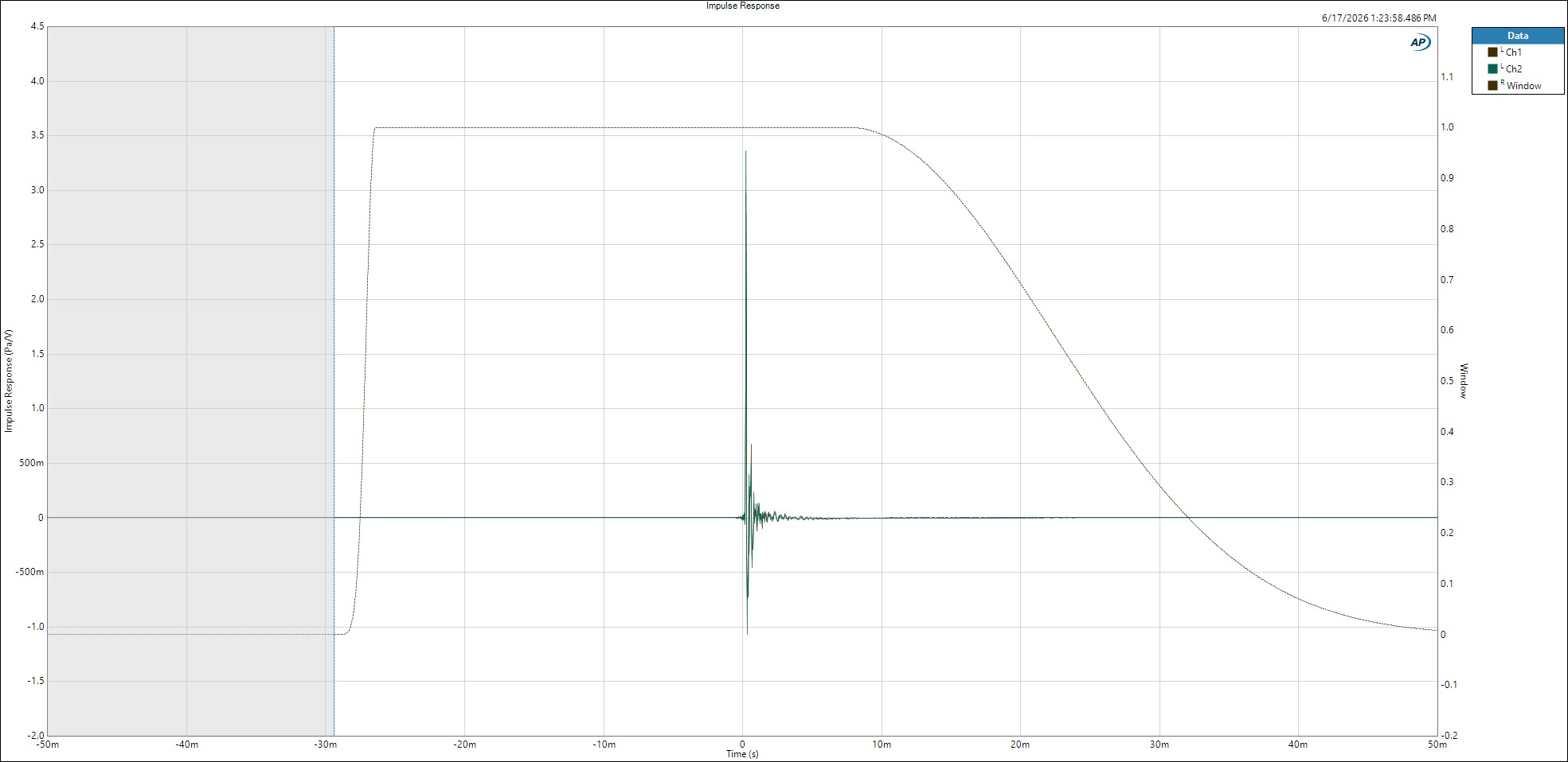

I assume you saw Dan Clark’s response on the HeadFi thread back in June, below the post you linked to:
“That looks odd, but I have no idea how that is possible. I just went and looked at the line and ran a physical test and everything is fine. Also, a phase plot like that isn't ideal, a simple impulse response is usually easier and clearer. Here is the impulse response on the AP, it's clearly correct. I also verified with visual inspection on an open driver. I also spot checked 5 units from production.
“While I won't say ‘it's impossible’ your unit is out of phase, given how these are assembled I don't know how this is possible. Accordingly I suspect something else is going on here. PM me and we'll continue this offline, please.
“EDIT: I believe your unit is SN 519, correct? Your unit's measurements are below, and you can see phase is correct. We have your measurements and your unit is in-phase. Still, contact me offline and we'll figure it out. :-)”
It appears that the manufacturer measures each unit, and the phase is correct, at least when they left the production line.
