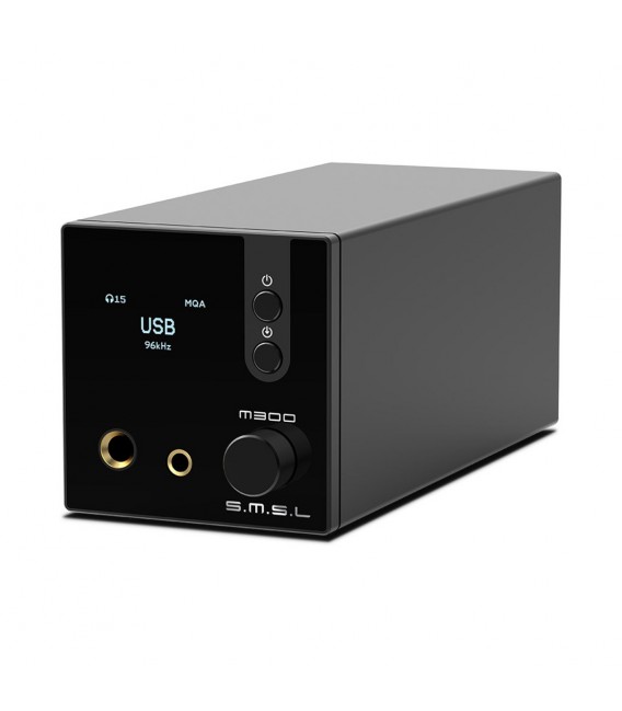

Looking for something relatively specific if anyone can help me finding this... Maybe it doesn't exist.
1. Budget - Up to $120. I realize I may need to go used here, and I am OK with that.
2. Performance - Sinad of 115 or higher.
3. Features - Must have volume knob on front. Anything additional is a bonus.
4. Input Connectivity - Must have USB input with C being preferred. Anything additional is a bonus.
5. Output Connectivity - Any chance I could find the above with balanced line level outputs? Anything additional is a bonus.
Physical volume control and balanced output is challenging. Any reason for the arbitrary requirement for 115 dB SINAD? Anything better than ~90 is inaudible so you can relax that a bit? 110 would be very safe, as would anything better than 100.
Single ended only
A bit over budget
Check out the Review Index here, lots of near-options :)
Hope you don't mind me piggy-backing this thread but I was about to start a near-identical one since my existing DAC that I use with my computer setup has just died.
A replacement must have XLR balanced outputs and a volume knob. These are my only two requirements. Although I have no specific budget, I'd like it to be as cheap as possible whilst being "decent".
What's your thoughts?
Edit: scrub that - just saw the Fosi Audio ZD3 review and it looks perfect for what I need.
Thanks

Yes, the 115dB SINAD requirement was quite arbitrary, just didn't know how else to put a "sound quality" requirement on it. Primarily looking for something with inaudible levels of distortion and noise and flat 20-20kHz.
The SMSL M300SE was looking like a winner for a minute, but I must say I am liking the extra features of the Fosi ZD3. I'd obviously have to up my budget, but the HDMI and 12v triggers could really come in handy.
