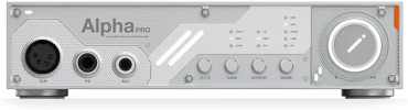

This is a review and detailed measurements of the D&A Alpha balanced DAC and headphone amplifier. It was sent to me by Shenzhen Audio and costs US $399.
No, you are not seeing double. What I tested before was the Alpha Pro. The non-pro version has the same distinct white LED and clear front panel with labels that are kind of hard to read. Otherwise, it is a very simple unit to use. I especially like the brightness of LED ring around the volume control changing proportionally to its setting.
I upgraded it before testing it. In the interest of digging my way our of mountain of gear here to test :), I focused my testing on balanced output unless said otherwise.

The Hifi Rose RD 160 - from which the D&A Alpha stole the optical Design idea is US$ 5995
and it has no headphone amplifier integrated.
15 x the Price of the D&A Alpha - perhaps a bit expensive- but one of the most beautiful hifi-items I ever saw:
The Transparent Aluminum is a Star Trek idea and now real!
I wouldn't say stolen. There are some similarities but the Alpha has a lot more 80s mecha look to it. I don't think Hifi Rose owns silver/grey and sans-serif fonts.
...and of course DSotM...
The forefather of the 80s mecha look revival:
I guess this is how D&A want to look if you let them build an integrated amp
Gawd that thing looks awful - designed for old wealthy men with 'something missing' in their lives, I suspect..... There are way OTT wrist-watches costing mega-mega-bucks that offer similar over-complexity to suit a particular mindset :D
