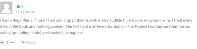

Forgive me if I don't interpret this charitably :facepalm:. The internet is littered with furious forum users and people who've tried the product and have given ample feedback that the company needs to change its ways. Personally, when I've dealt with clients who have Rega setups, it causes an issue half of the time, all for a tiny little wire...
Rega: Just say anything, make anything up, say you've changed the electrical alignment of the design or some other BS, but fit the ground wire!
