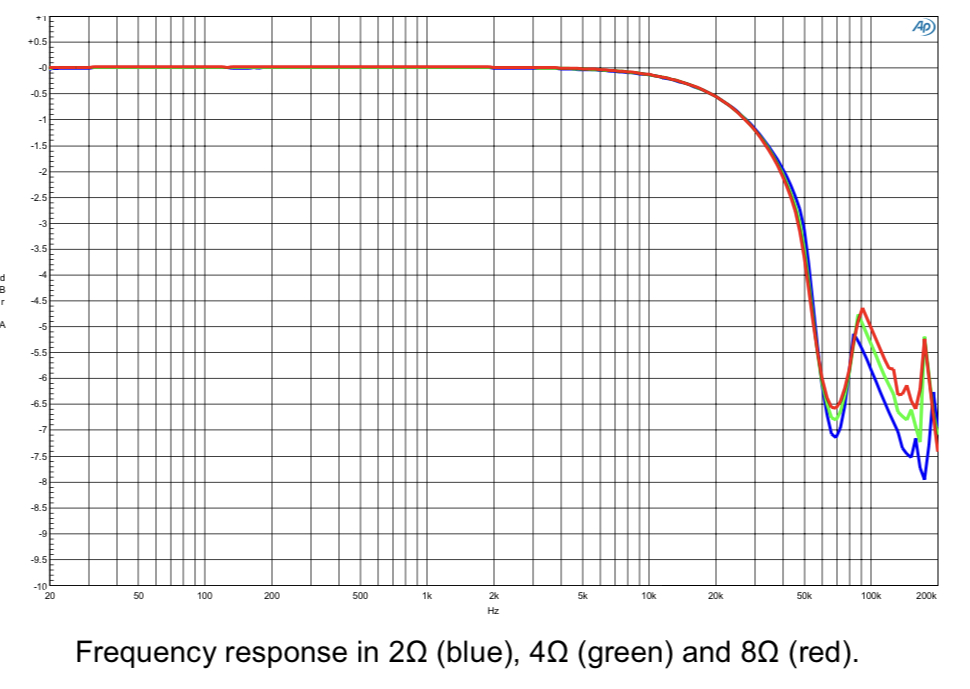

It seems to me that designing for ten times the audio band is a design rule of thumb to account for a range of things that affect performance downstream. The NC502MP claims a 0,-3 dB bandwidth of 50 KHz, but does roll off frequency response in the audio band by more than 0.1 dB near 20 KHz. So, the “limited” bandwidth means it’s 0.6 dB down at 20 KHz. (I put “limited” in quotes because I doubt the audibility of this roll off.)
But the graph is post-filtration, right?
Note the vertical scale. Plot this on a graph with 5-dB divisions and the frequency response would look flatter over a higher range.
Rick “wondering whether power bandwidth includes filtration or not” Denney
Graph is post filtration.
