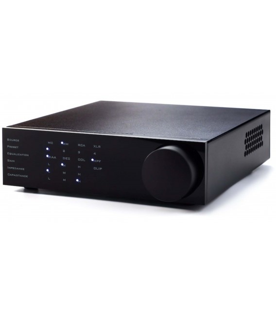

I'd recomend you buy a miniDSP PocketADC, miniDSP ADept, or possibly a Parks Audio Waxwing if you see value in its Vinyl-specific DSP features.
Then you can easily connect your turntable to the DX9 via SPDIF, and create rips using a Hifime UR23 (PocketADC/Waxwing).
For rips, the ADept can be plugged straight into a PC via USB. No additional DDC required.
Thank you. Yes, for me it's probably the second one is the most interesting, as it's “all in one.”
I hadn't heard of the third one before, but I looked it up and it's not bad, but I don't think I really need DSP.
It seems like Adept is expensive, but it really has everything I need—phono, recording, and the spdif output for dx9.
I'll probably buy it =)

If you are going into vinyl I would suggest a Waxwing phono preamp. One has to appreciate that technology has evolved and since no software exists other than the RTclickrepair that is no longer supported, the Waxwing would cover all your needs. Other than that a good cleaning device and a decent cartridge to go with your turntable.
