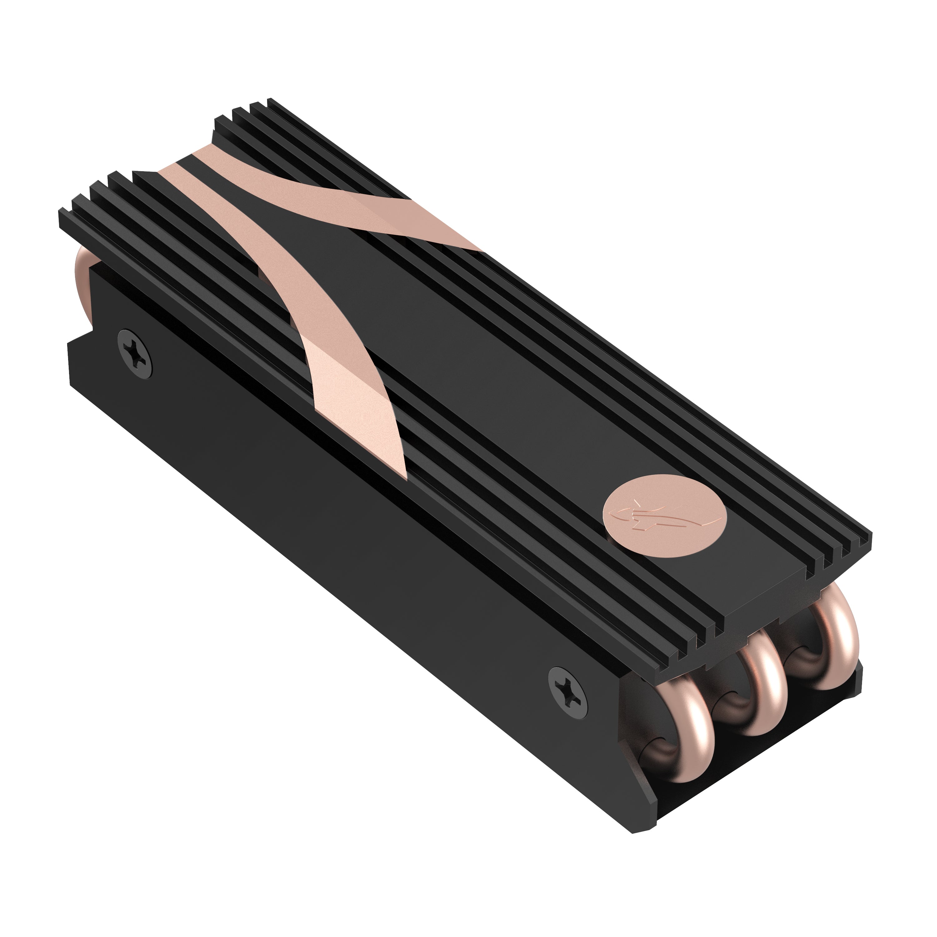

Slightly offtopic, but for NVME cooling I recommend a well built copper cooler. Does the job and one less fan to worry about.
so this is just a quick off topic reply: the Sabrent you mention, at Amazon review, a lot of owners said once they connect it to their NVMe drive, they lost the drive. I use active cooling on a brand called JinuShark m.2-3
No idea how they do that. It's just a heatsink, doesn't connect to the NVME in any way besides via a thermal pad on top and/or on bottom. It's possible to fit this wrong, which can result in a bad connection at the m.2 socket. But this is a problem with all heatsinks needing to be properly fitted to the drive. One has to do it really wrong to achieve that though. There are holes and markers, it's hard to completely miss all that.
This heatsink looks like a joke. Nearly no cooling surface and a heatpipe, which serves no purpose. Sorry for continuing offtopic, but this is really weird product.
It's pretty heavy, works good, can do more than stock heatsink-options on expensive Samsung Pro or Corsair Force f.e., is or was cheap, was even free with Sabrent Rockets... but it's just one of many possibilities.
Actually measured with some prosumer drives under sustained load and in normal tower airflow. But the goal was more like: can it keep the drive under 60deg at any time?
So BICS and Psion still. I don't know what are you opsesed with, it does suck a lot under peak load but you won't have that ever in regular use. If it's same SoM same NAND and controller all generic or branded for same will work fine (same offset and hight of chips and controller). With 30+ W max they do need a heatsink but stil ambient temperature insade case will be determining factor. Don't do it to one's (heatsink) it's not ment to go with like Samsung or WD.
In any case watch the NVME sensor, put actual workload on and see if the temperature is good.
Desktop work has only small bursts. That temperature still needs to be contained, but it's not i/o heavy load.
Apologies for extending the OT, but this is a science website and there is science to be scienced
- I have seen people wrongly tell me a heatsink was DOA from the box. Only to teach him that he assembled it wrongly. So humanity is capable of unimaginable things.
- Heatsink area and airflow affect heat dissipation, but heatsink mass affects heat inertia. The block of metal helps absorb temporary bursts of power, even if does not improve the temperature under sustained load. Like a capacitor vs a power supply.
-- The heatpipe can actually be required in such a case, because a block of metal is still thermal impedance. Instead of the heat traveling through the entire block before reaching top surface, the heatpipe quickens the process.
--- Ultimately, regardless of what we can guess, the end result decides everything. And people have tested it to at least do something. This website is build on testing more than seeing, do not forget that.
- It's actually doing a bit better than the MC1 Pro, which with all the fins and stuff you'd think would be a great performer.
- That being said, a gaming motherboard already comes with a heatsink of its own, often with heatpipes that lead to more fins. Those are usually sufficient. But yea, if you need the Sabrent heatink, it does its job.
I have read a no. of youtube review on M.2 heatsink w/ a little fan in the middle. Their conclusion is, where the fan is located, that portion of the heatsink IS COOL. But the rest of the heatsink is hot.
the idea of the Jiushark m.2-3 is, in essence, a miniature ver. of your CPU block, where there is a heatsink and a fan that blow all the heat of the entire heatsink out of the way.
Only time you can get close to full utilisation for prolonged time is if you do synthetic benchmarks, stres test or if you seed CHIA (cripto which no one does anymore). You shouldn't do any of that anyhow. I have older Psion and Kioksia BICS PCI-E gen 4 in Coshair branding with its stock cooler for years. Under regular heavy load of system and to SSD like gaming its delta under ambient temperature of 21~22° C is 36° C and motherboard/case lambda stays at about 26~27. Talking playing for hours and hardly there is a real load that it will ever see that's harder then that. It's gen 4 27W, gen 5 got to 31~32W and OEM's made a little better coolers to go with them, nothing really changed. Absurd is in real loads other then boot up you get zero advantage even compared to old SATA SSD's.
Chia plotting is one of those workloads where over hours, days, weeks it gets too hot - or stays in a desired area. Improper cooling solutions, lack of airflow, it will all show.
All of my modern boards come with large alu plates. They work well and don't get in the way.
Then there are Hyper cards and clones. 4 x nvme with 16 lanes in a mid size pcie card. Full alu cover, integrated fan. Good prosumer solution.
If you ever put a fast nvme in a external thunderbolt4 passive cooled brick, it will demonstrate nicely how much heat there can be to transport away.
Yes, it works. But compare it to a reasonably designed device, which use heatpipe properly and provide adequate cooling surface:
