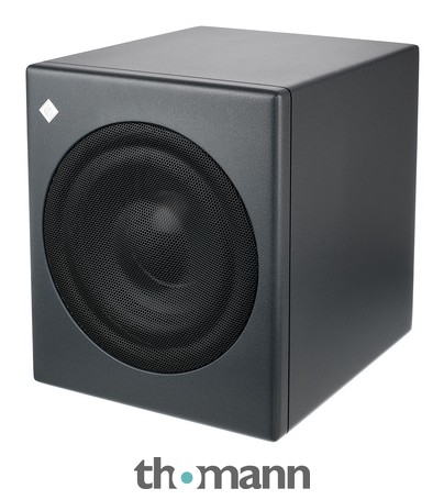

Yes this is good advice. However, I was hoping to go secondhand as I’ve seen the KH750 go for as low as £700-£800 secondhand.
Mine was second-hand. It worked perfectly. The only problem I had in the long run was visual: some cracks appeared in the cabinet. It didn't affect the sound at all. Then I sold it again because I needed the money, and the new owner is delighted with the sub, as far as I know. It's a good option for testing equipment.
But remember MA-1 is not included (IIRC).

If I went with the KH750 + MA1 and used it in the same position as my current Eve TS108, would this still be a better option than to use a single pair of KH120mk2/KH150 + MA1 or the PDP MUM-6 with the IK ARC Studio?
It should. But it's kind of a guess...
If you go secondhand and don't like it, you can probably re-sell them and not take too much of a loss.

I know this forum is the church of Neumann/Genelec but I take issue with the blind recommendations of their subwoofers. There's objectively nothing special about the KH750 at 1500 euros. Of course if you don't want to deal with the learning curve of doing your own measurements, you have to pay the exorbitant fee.
Just seems excessive to buy a 1500 euro subwoofer to fix room modes, though.
