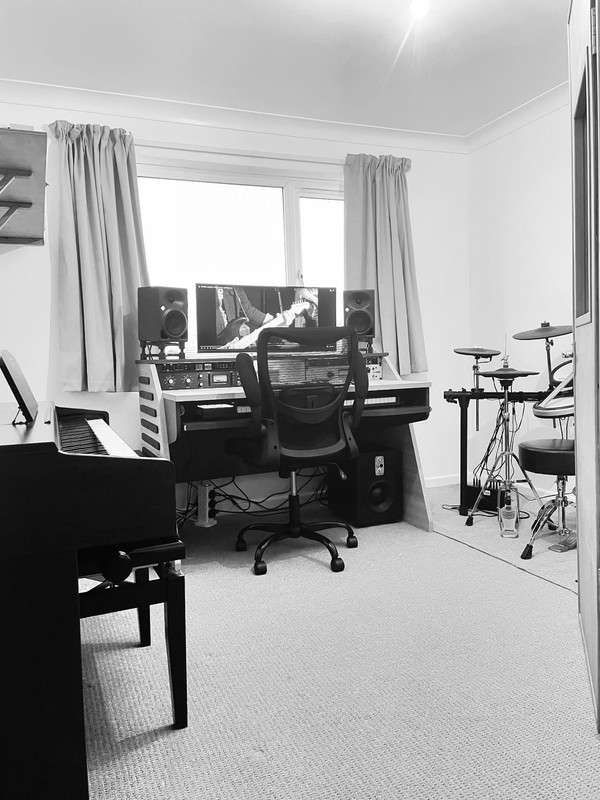

At the moment I’m using a pair of Neumann KH120’s for mixing in a small home recording studio. My room is a slightly odd L shape which isn’t ideal but I’ve had to build a vocal booth,
Here is a photo of the room
The KH120’s have generally been really good speakers for mixing though not perfect. I also have an Eve TS108 sub which is really good but I can’t get it to perfectly integrate with the KH120’s. I do find the sub useful for checking sub frequencies and for impressing clients However, I can’t get away from the fact that I can hear certain room mode build up at various frequencies.

Also, before selling or buying another set of equipment, why not try changing your listening position? I understand it's quite a bit of work, but you could try other configurations. The window behind the speakers is probably causing some problems, and the subwoofer under the desk is likely making it vibrate. All these things ultimately affect your listening experience.
Thanks for the suggestions. Unfortunately this layout is the best fit for the shape and size of my room.
