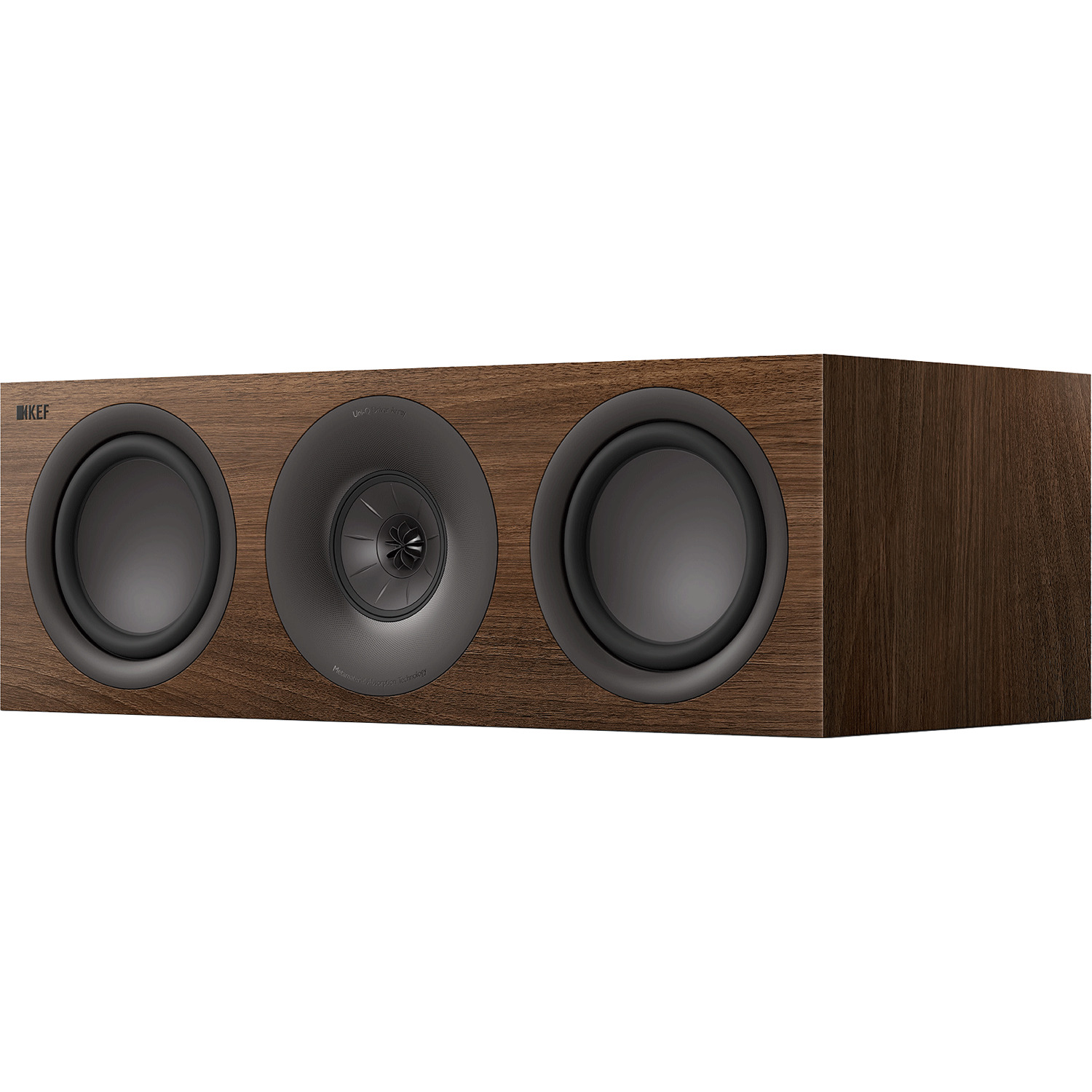

If your budget can reach $650 then a recertified KEF Q6 Meta is possible. This will give broader vertical dispersion and likely better mid-range/treble quality, KEF coaxial drivers are some of the best on the market.
