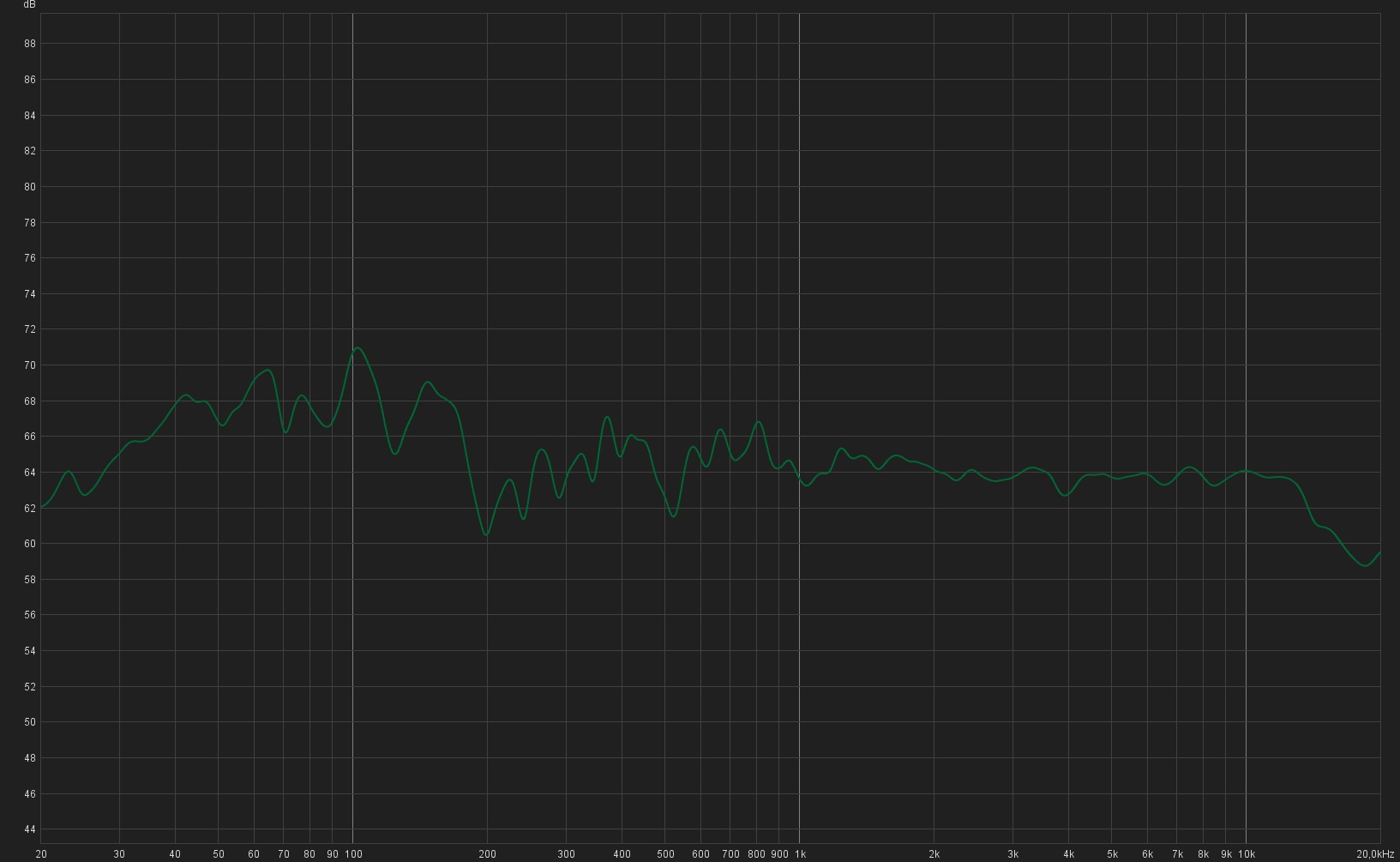

I think it's worth noting that the rooms being spoken of here ("dry AF everywhere above 200-400hz") are typically those where a lot of rather band-limited treatment has been used. If you cover your entire room in 2-4 inch panels, that would be the end result generally. Treatment should be strategically placed, and when used, it should be broadband, which is why my thinnest panels are 8 inches. In my case it is not necessary to make these panels more reflective at high frequencies, as they are used sparingly (only about ~12% of my wall surface is treated, and that's not counting the floor and ceiling). Using a lot of treatment on a small surface > using a little treatment on a large surface.
Here is the in-room response of my Gradient Revolution, only 3 EQ points applied. 1 peak filter of -5dB to pull down a room resonance at 110Hz, 1 low-shelf of about 3dB@150Hz, and 1 peak filter of about -2dB@800hz where the speaker itself has a resonance. Note the 2dB divisions:
gradient-revolution-mmm-eq-jpg.950766
Listening distance is 2 meters. Dip at 200hz is boundary interference. Smoothing is 1/12 octave. Measurement method is MMM over a very small listening area. There's no less of high frequencies present here (the sharp drop above ~12-13kHz is the speaker itself, not the room). In fact the speaker is arguably quite bright, due to the flat-ish frequency response and almost constant directivity down into the bass (cardioid midrange and dipole woofers).
