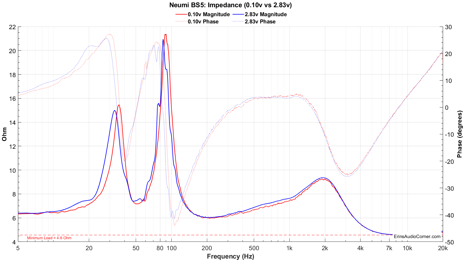

Compare the impedance curves. Eyeballing it, it looks like there *might* be a slight difference between the 5-10kHz region (maybe 1 Ohm). But, maybe that's just my eyes. They could be the same.
index.php
No, prob not your eyes, there are 2 likely explanations. One is scaling differences, the other is the output level in measuring the impedance. Recall Amir drives the speaker at a higher level than I do. The key parts are that the frequency peaks and valleys are aligned.
Cannot expect the impedance values to match unless drive level is the same (and we know that they are not) :).

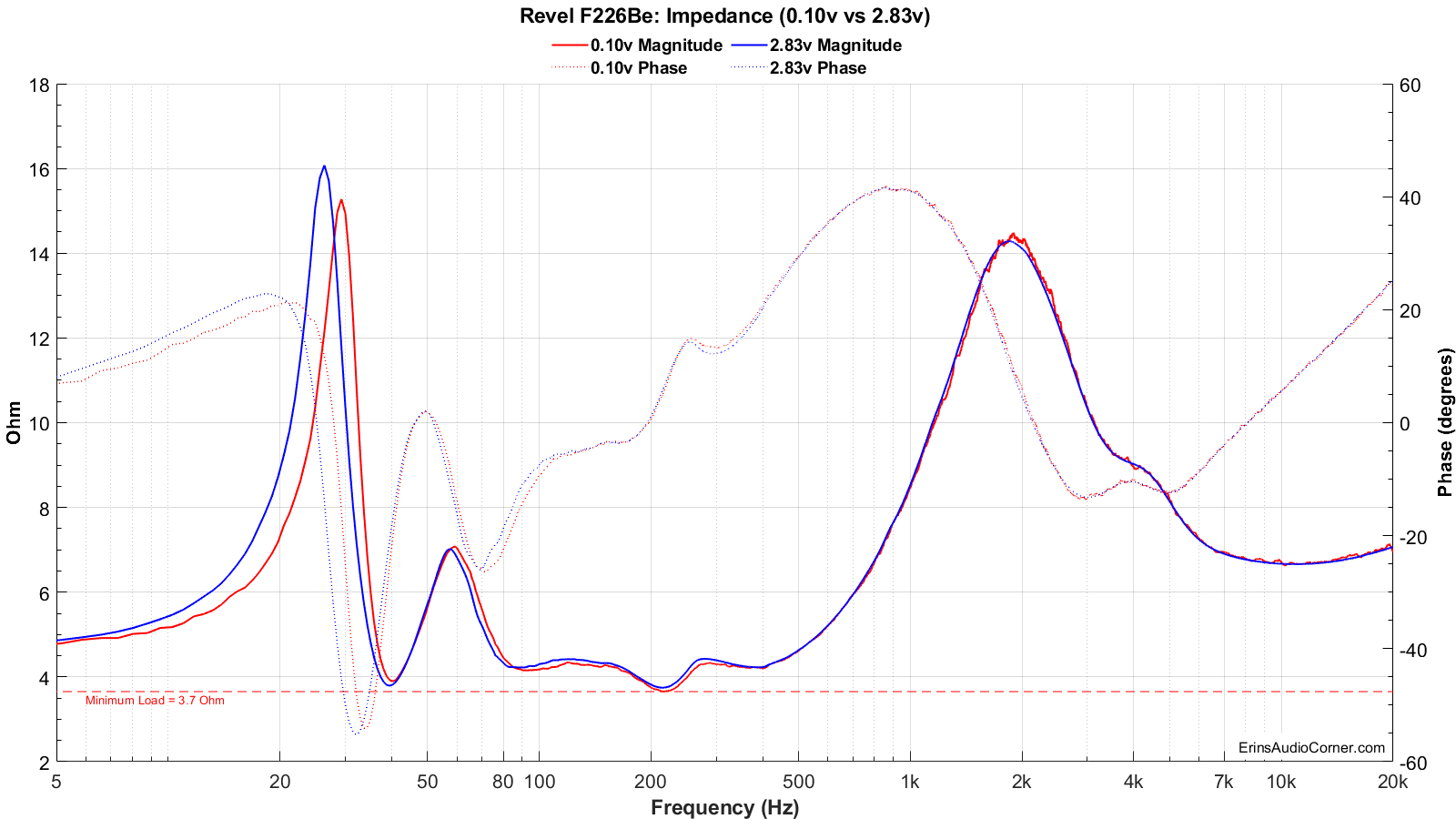

That's not true. At least, not for the HF.
Here is an example of two extremes. One with 0.10vRMS vs 2.83vRMS. I do this with all my tests so you can look through others.
and here is a $90/pair bookshelf speaker to prove that it's not just good QC by Revel:
Surely these differences are within measurement error? I see at most a 0.4 Ohm difference above 5kHz.
Agree, am sure Amir’s measurements are better than mine. Have improved equipment on my bench, but these were measured long before I got my new setup.
If one thing I learned in 30 years of industry, unless you are duplicating with same equipment with same conditions, you may not see the same results. :cool:
Two things:
An impedance sweep is easy. Especially of a speaker. There shouldn’t be a noticeable difference between setups. If there is, one of setups is wrong and is not a reliable source of data. And as I have shown, drive level is not a factor in HF.
I questioned the impedance as a way to see if that might explain the HF drop. I didn’t say it was there. I just noted that it would be an easy way to explain the HF difference IF the two showed a marked difference (which I did not think they did).
That’s all I wanted to convey. Peace, love and Mickey Mouse! :)
