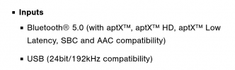

Is that with the M20 HD connected via USB, or via 3.5mm Aux?
When you connect the M20 HD to your laptop via USB, then you should be able to select up to 24bit 192kHz:

You may have to install the M20 HD's driver to be able to select 24bit 192kHz with it connected via USB.
You can download the driver here: www.qacoustics.co.uk/m20drivers (choose Win10 if you're using 11).
Here's how the user manual describes the install process:

@Morph9683
