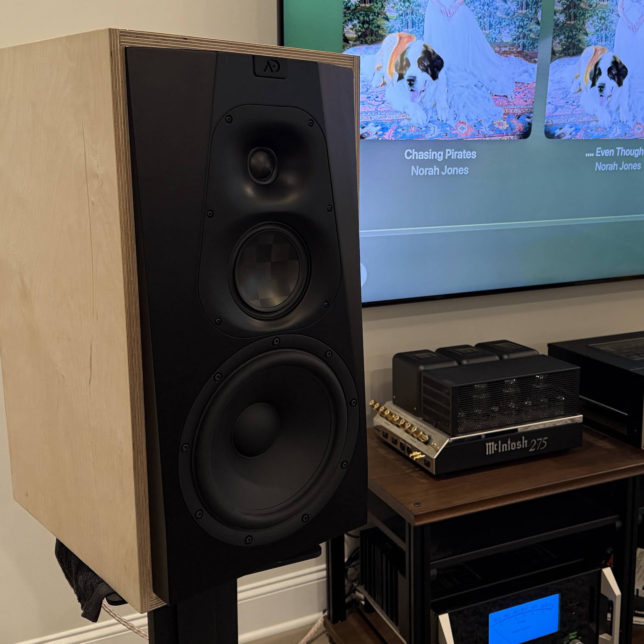

View attachment 492911View attachment 492910

Kit ordered! Pretty excited to start the project, and will have the time to think about what finish I will do. Also, my plan is to build speaker stands over the next few weeks. Can anyone provide the recommended stand height for the Cadentia 3s?
I will recommend trying to aim the tweeter at around your ear level.
i compute 15”-16” as a good height for a stand.
