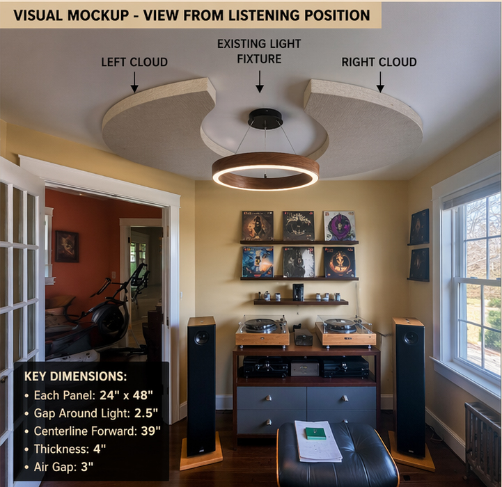

My "dedicated audio room" was my home office before I retired. It was great as a small home office, but the same properties make it less than ideal as an audio room:
(not to scale, it's far more "tighter" than the diagram looks)
It's small and asymmetrical, large windows and not much choice other than to sit in a 50/51Hz "null" point.
I used REW and an EM-01 to get it as good as I could with positioning. The imaging is fantastic. Delicate, nuanced and extremely detailed...and it even sounds pretty good to me as it currently sits, even with a measured 130hz SBIR issue and a 50/51Hz null. The 130hz is pretty deep, but it's a smooth transition in and out of it and the 50/51Hz null has a smooth entry and a rapid/strong recovery at 52-55Hz. The SBIR goes away with the tower speakers within 3" of hte rear wall, but that introduces too many other issues that just can't be dealt with (imagin, soundstage, etc).
The rest I'm planning to deal with by some absorption and a second sub to try and excite that 50hz null a bit more.
As I still have to enjoy living in the space, I want it to look decent and not feel closed in. That means no heavy curtains on the windows, so I have to live with that.
The SBIR I can't really make "go away", but I can smooth it out a little bit. That will be bass traps sized to the room limitations:
and the ceiling will get a cloud treatment, trying to keep with the style of the room as well as look "aesthetically pleasing":
that cloud covers pretty much all of the ceiling reflection areas.
The current 8" sub is located near field to the listening position (26 inches from rear wall), which was the best compromise in the room for the physics of it. A second sub will be in the 12" cone range and located off axis to try and excite that 50-51Hz null a bit more and add a little extra "depth" to the bass. Final location of the subs will be REW measurement driven and of course, the limitation of the rooms available spaces.
At that point, I'll have to be satisfied with what results I get because there's only so much you can do in a small, compromised room that you're only willing to make so many tradeoffs for SQ. As mentioned, I have to enjoy being in the space as much as listening to it.
