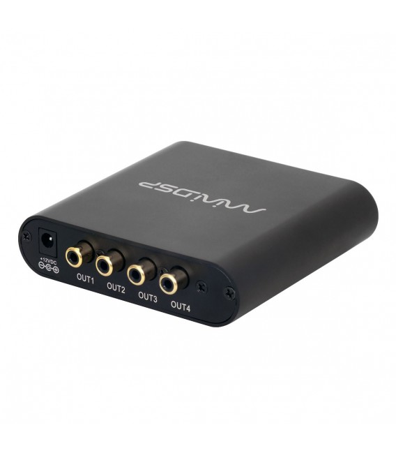

The only things that I know of that offers DSP on top of DIRAC Live are a miniDSP and a PC with appropriate software.
So a MiniDSP Flex + WiiM Mini would work, or a PC/MAC with multichannel soundcard can also act as a streamer.
Thank you Woodooless.
If I have to go using a PC to achieve this, then I will accept.
What about :
MINIDSP SHD STUDIO Processeur Audio Numérique DSP SHARC ADSP21486 Dirac Live Lecteur Réseau Volumio 1200€
or
MINIDSP FLEX EIGHT Processeur Audio DSP 2x8 Channels SHARC ADSP21489 XMOS Bluetooth 5.0 aptX HD LDAC 800€

Get the flex 8 if you need more than 4 channels (multichannel active speaker).
The SHD studio streamer is kinda limited, digital only. IMHO. Not worth the money. The DDRC is kind of legacy.

This is literally what I proposed in post #2 :facepalm:
Mini is enough if you only need the digital output.
yes you did actually, interesting.
What I meant was that I did not see this solution in other discussions on this forum.
I suppose that you then mean
with a mini wiim and a PC.
I have to figure out how this will work then, if it is not an overcomplicated setup to figure out ?

Why flex 8? Do you need more than 4 channels? But really, the price difference isn’t that large, and since your goal is some experimentation, it might make sense.
The flex was mentioned multiple times in those other topics of yours. Others also pointed out that you don’t need the WiiM ultra in that configuration.
