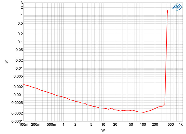

Here is Stereophile's measurements of the version 1 (?) of this Buckeye amp:
Notice he had to change the vertical scale and have it to 10 times smaller for Buckeye!

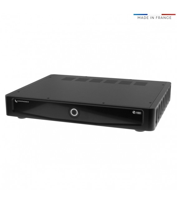

Checkout two choices
Thank you, @daniboun, these also look nice, don't they?
Superb performance, but the price is prohibitive in my opinion, especially for a mono bloc....
