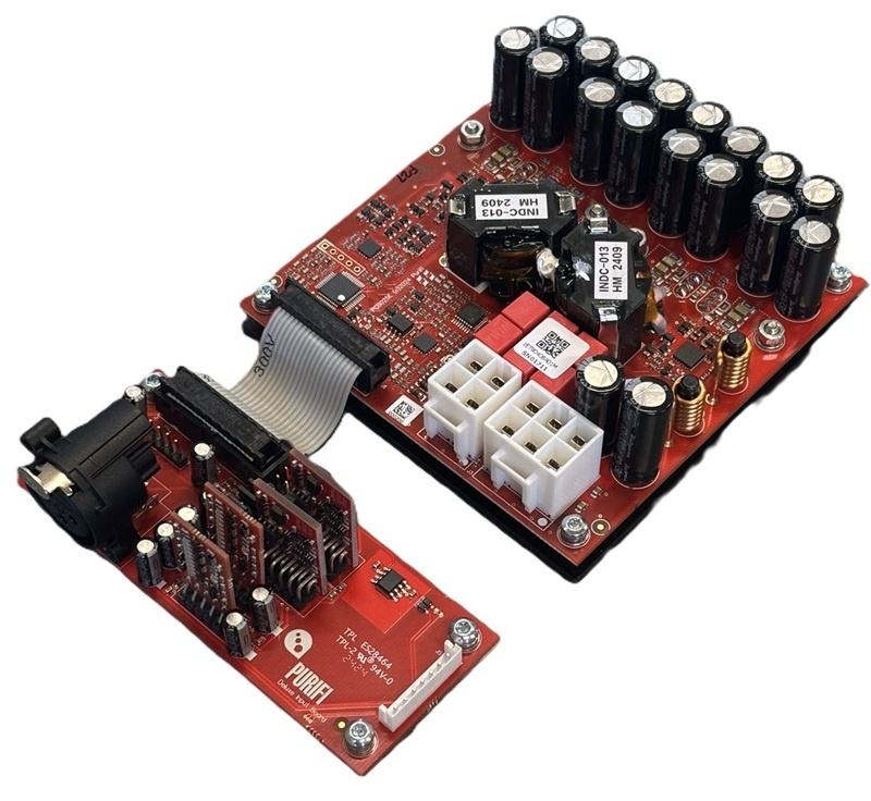

The connection on the board is IDC, which is made to be used with ribbon cable, I believe. It would be difficult if not impossible to procure a different sort of cable that can mate with an IDC.
Why the IDC connection was chosen for use on the boards is something you'd have to ask whoever designed them.
While I agree that a ribbon cable is not really appropriate for use inside an audio amp like this, the cabling and general assembly are well laid out and we can see from the results that it's a non-issue here. Noise and distortion are below any conceivable audible threshold, even if you're using some obscenely sensitive speakers.
The designer for most of the amps is Bruno Putzeys. As many of these amps use ribbon cables to carry the input signals, he clearly felt it was suitable for audio signals. One notable exception is the Nilai amp that Amir recently reviewed. It has shielded twisted pair cabling for the audio inputs. Its SINAD is a few dB worse than this Buckeye 9040 amp. As has been discussed, often it is not so much about the kind of wire used, but how it is routed.
The IDC connector will accept other wiring than ribbon cable. It was popular to use Mogami shielded cable with a Dupont connector in some earlier Hypex amps. Being much less flexible than ribbon cable, it put added strain on the IDC connector and many subsequently abandoned that approach. I had a number of Hypex MP series amps using the Mogami wiring. The Hypex eval board uses ribbon and eventually I replaced all my Mogami cable with the ribbon cable. The connection to the XLR connector(s) was via shielded twist pair cable. The ribbon connection was much more reliable and often measured just as well as the original Mogami cabling did.:)
