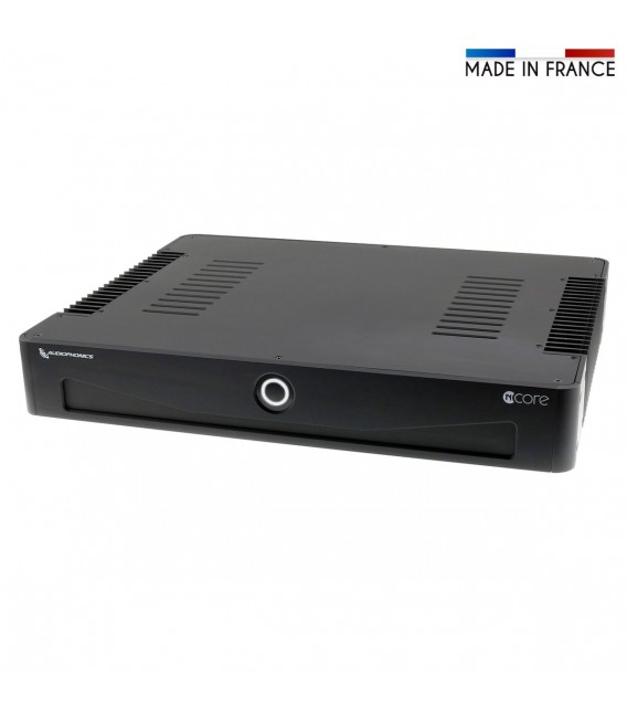

This buckeye amp is hard to find in europe.
But this audiophonics amp is :
It's a 4 chennels amp made with 2 Hypex Ncore NC252MP
Should it perform the same way than this buckeye ?
Buckeye also sends to Europe. But if you want an European manufacturer you also have Audiophonics, Nord, Apollon, KJF Audio, etc. Several options for you to research and choose from.
