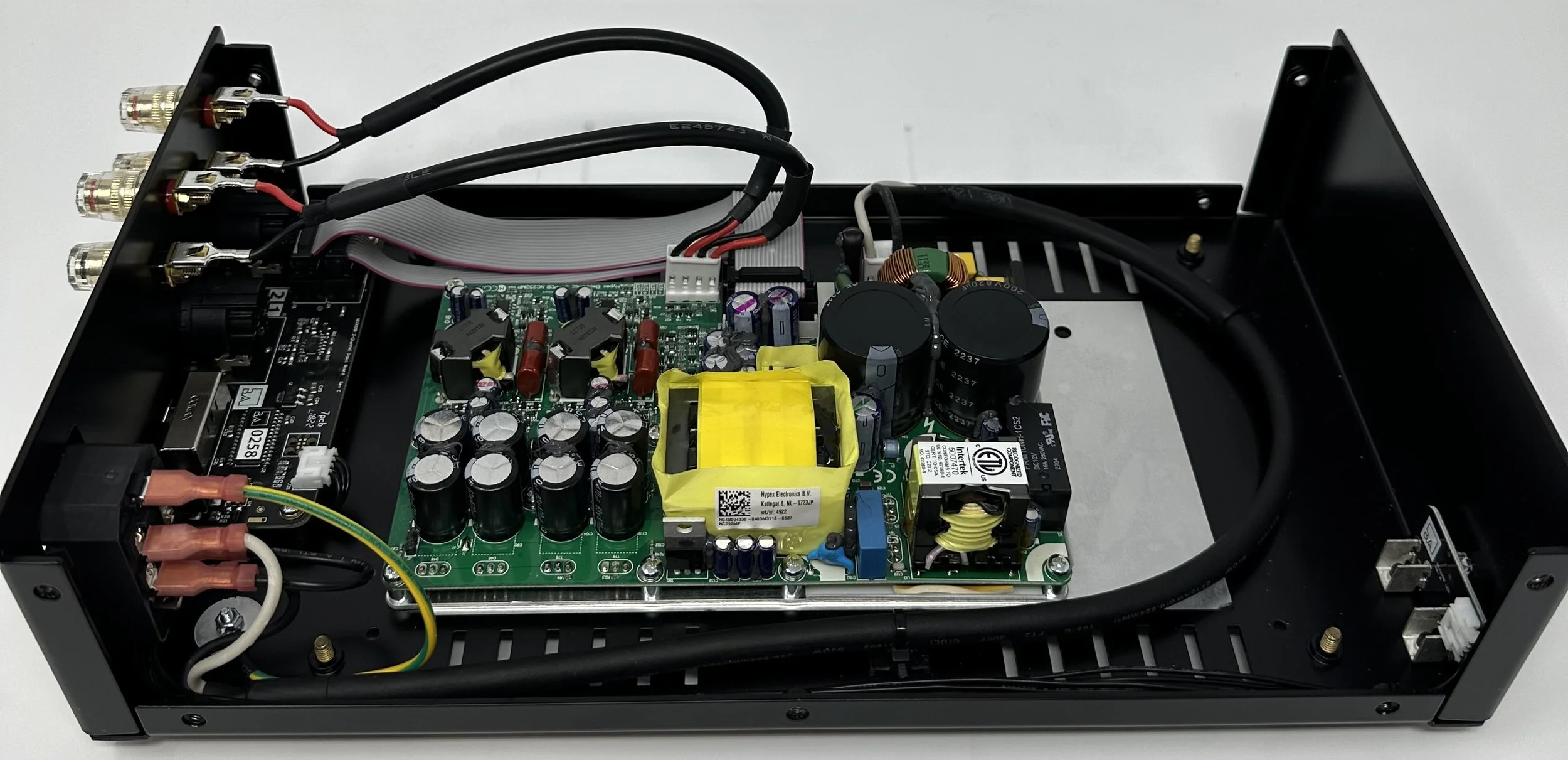

Yes, the Buckeye case is rather pedestrian, but in all fairness, it is more case than the Audiophonics AND more features. The Buckeye has clipping detection and auto-sense that the Audiophonics does not. See pic below…
Note the microprocessor-based input board on the left side. As for any difference in audio performance, the inputs go directly to the Hypex module. So, unless the tested amp module is unique in some way, any other OEM will have same performance.
