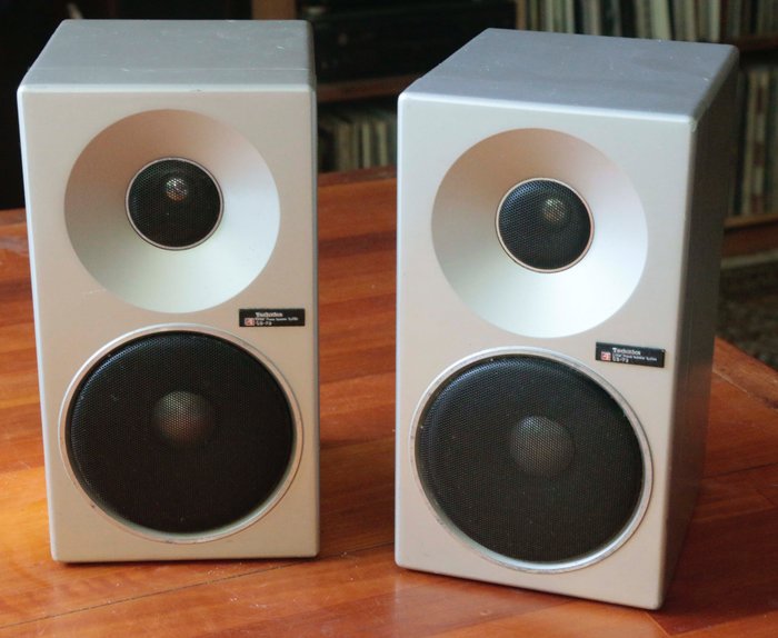

How many decades ahead of their era were the Technics SB-F3 when they chose this design!...
Would like to see ASR-level review measurements of those, and other efforts by Japanese brands during the late 70's and 80's...
Peace.
