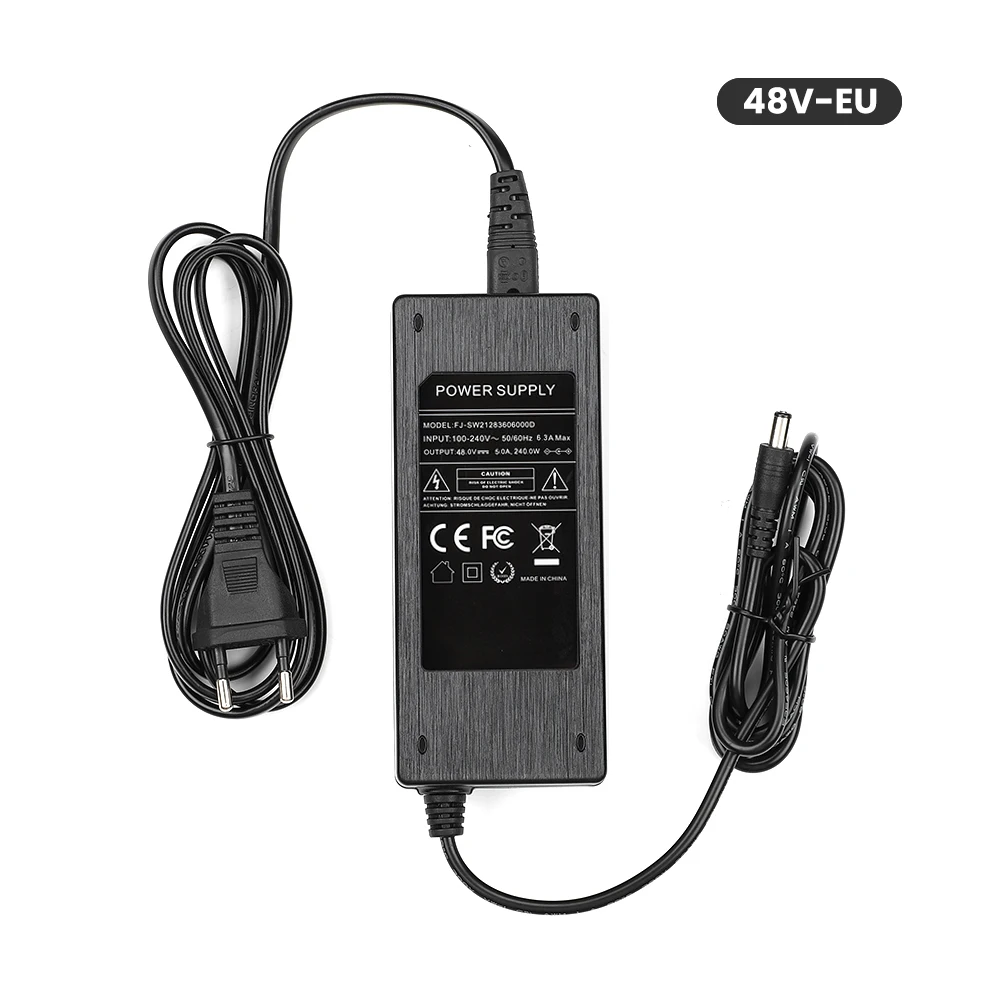

I just ordered the pre-order PSU FJ-GN224048005000 from the Aiyima shop at Ali for my Fosi v3. There is a sales coming up making this currently an even better deal for nearly 30 Euro sent to NL. I asked seller to confirm they will be sending the model number as pictured. Will report back what they reply. The v3 is currently powerd by the FJ-SW21283606000D which I received despite MXD 3606000 being shown at the time. This was bought from a different seller though, Yimaglobal, and they have since updated the picture to reflect the new 36v version.
I cancelled the pre-order as I received answer it's not the one they are advertising with they will be sending. @Idrago , your doubts were right.
Edit: pictures are changed now to different PSU.
No comments, it is obviously a practice, they have already changed the offer, there is another image, a model that does not match, model FJ-SW21283606000D with 48V 5A, their paper supports whatever they want to write!
https://www.aliexpress.com/item/1005006060750495.html;
