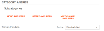

A detail, but while we're at it : the A series menu displays nicely in English
Not so much en français, where the multichannel vanishes (Mozilla/Windows) :
That being said, navigating and filtering options within each subcategory seems to work fine as for now.
Yeah, that's one of the reasons of the needed major overhaul. There are two much bigger bugs on the same page (apparently 3 now), one visible by end users, but I am not owner of the code so we have to live with it until we migrate to something else.

Are you also browsing from an Apple product?
Yes, Apple MacBook Pro, MacBook Air, iPhone all show the same. Boxem site totally unusable...
On the bright side only 40% of the internet uses an apple product for browsing now... :D
